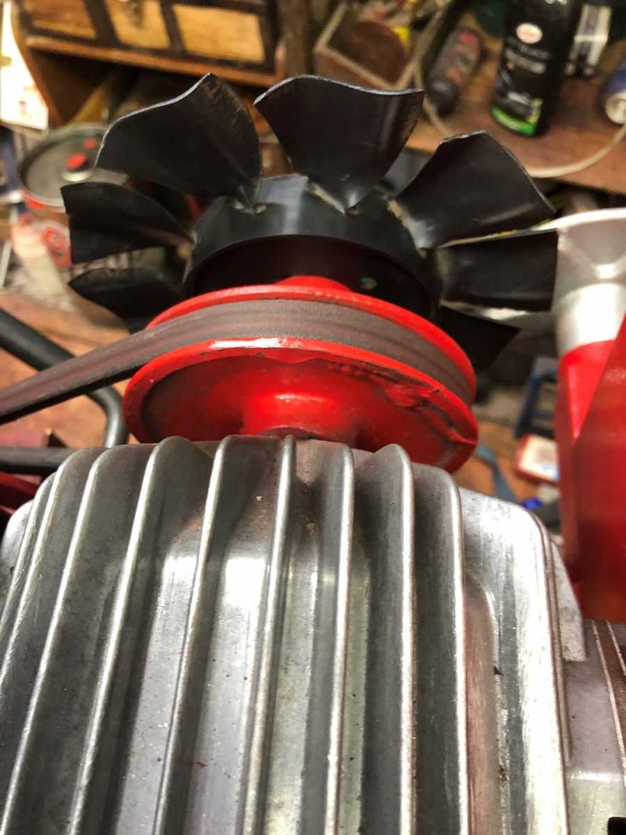

28 Apr 2019 23:09 #15373 by Gene K
A picture of fan made up since it was missing

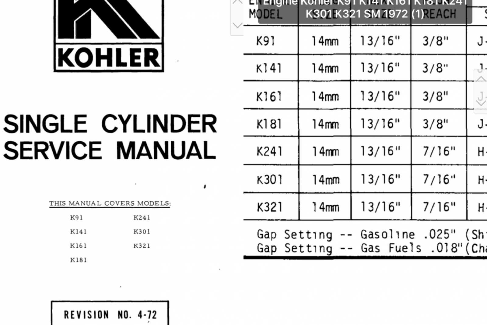

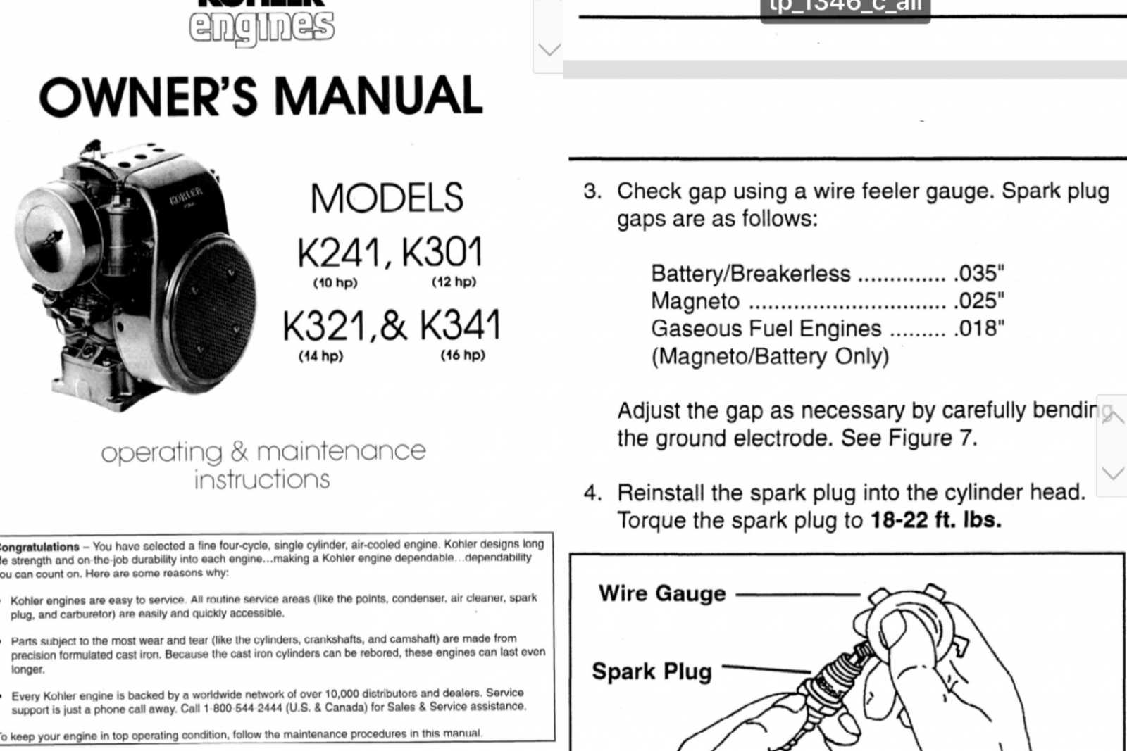

Ok two places tell me something different, one tells me .025 gap for plug other tells me .035 so which is it?

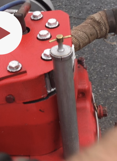

this is the pipe sticking up for oil fill which after some searching found it actually was an option
30 Apr 2019 08:33 #15386 by Geno

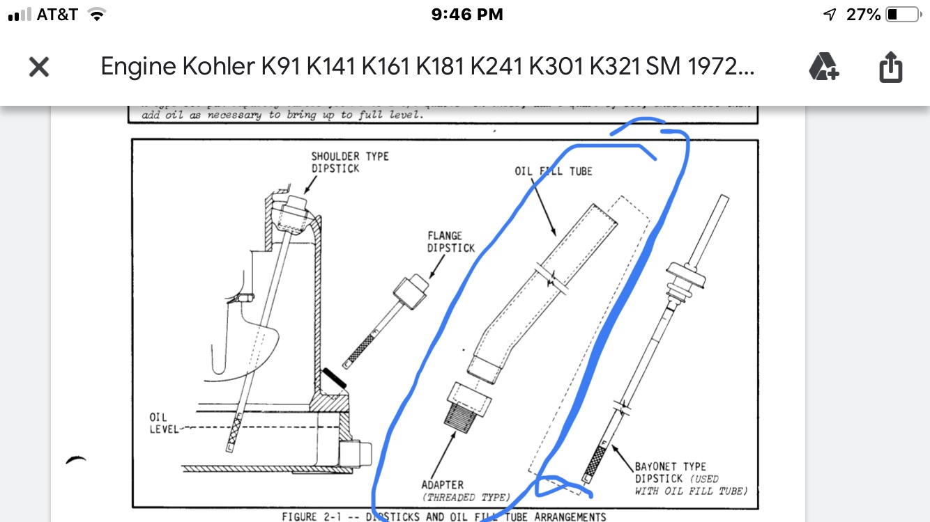

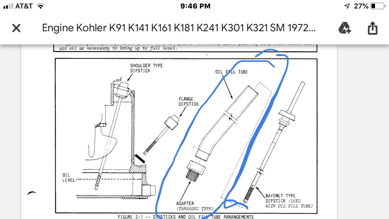

Spark plugs are .025, points are .018. The Kohler parts and service manuals have a lot of different configurations for a lot of different makes, each make is separated in the parts and service manuals. I have several very old Kohler books that I rely on and stick to the Wheel Horse section, and the actual Wheel Horse manuals. The pic you have says it's for a 1972 as well, not a 1966. In 1966 Wheel Horse had a shoulder type dipstick. :thumb
The pic below is from the Wheel Horse manual that covers the 1966 1076 and 1276. It shows the configuration.
