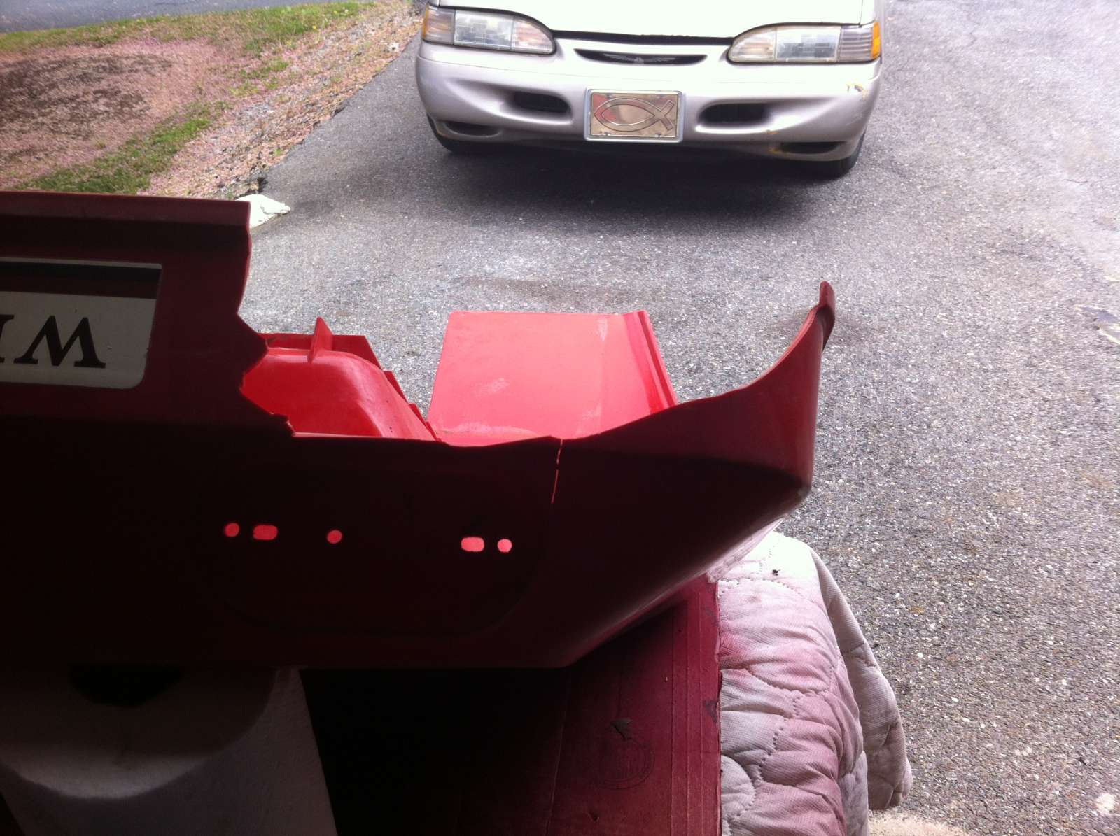

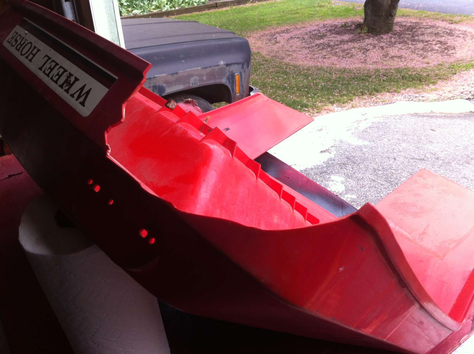

I have a sheet of 1/8 ABS and I am fabricating a patch. I think my trusty JB Weld will handle the job.

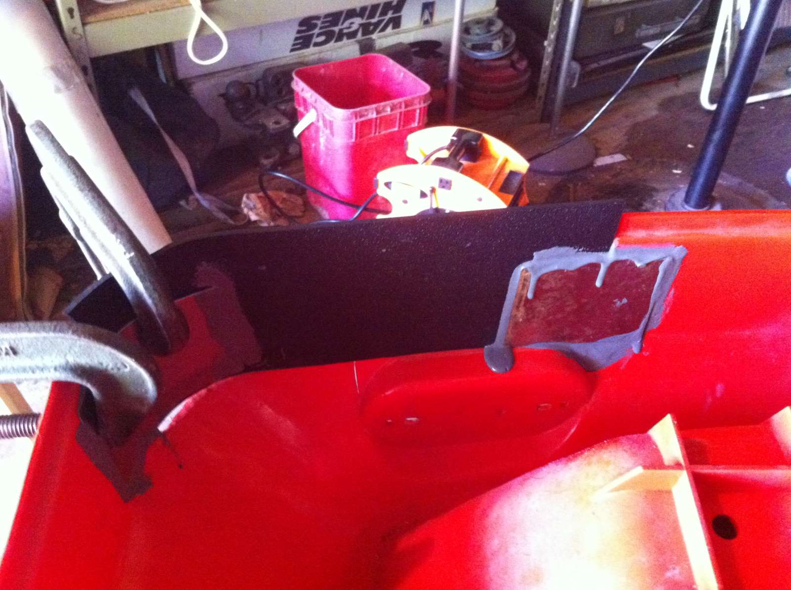

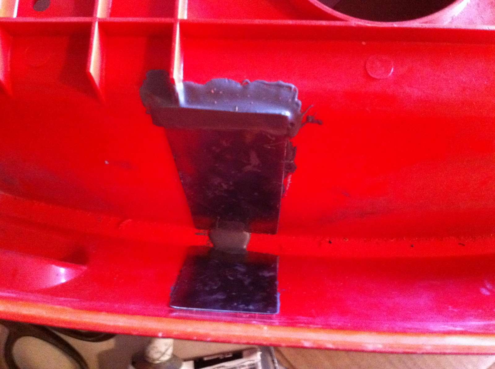

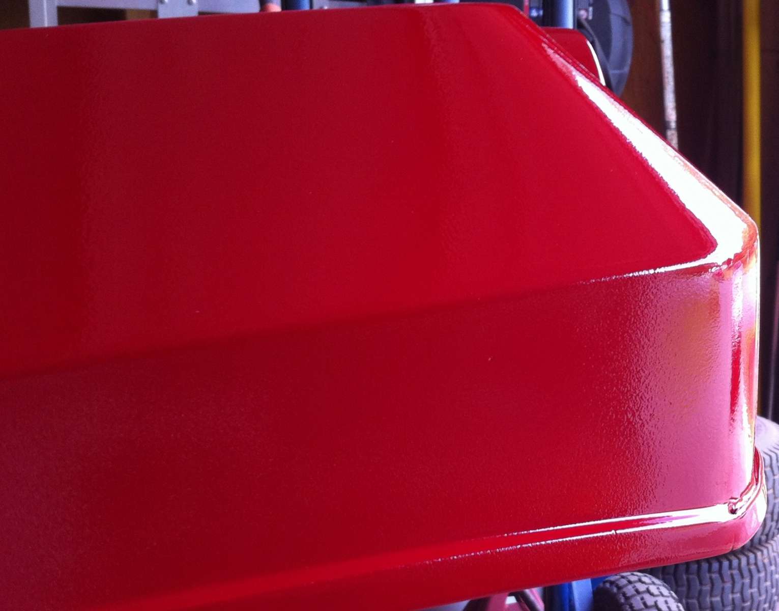

Replied by GT 14 on topic Plastic fender repair

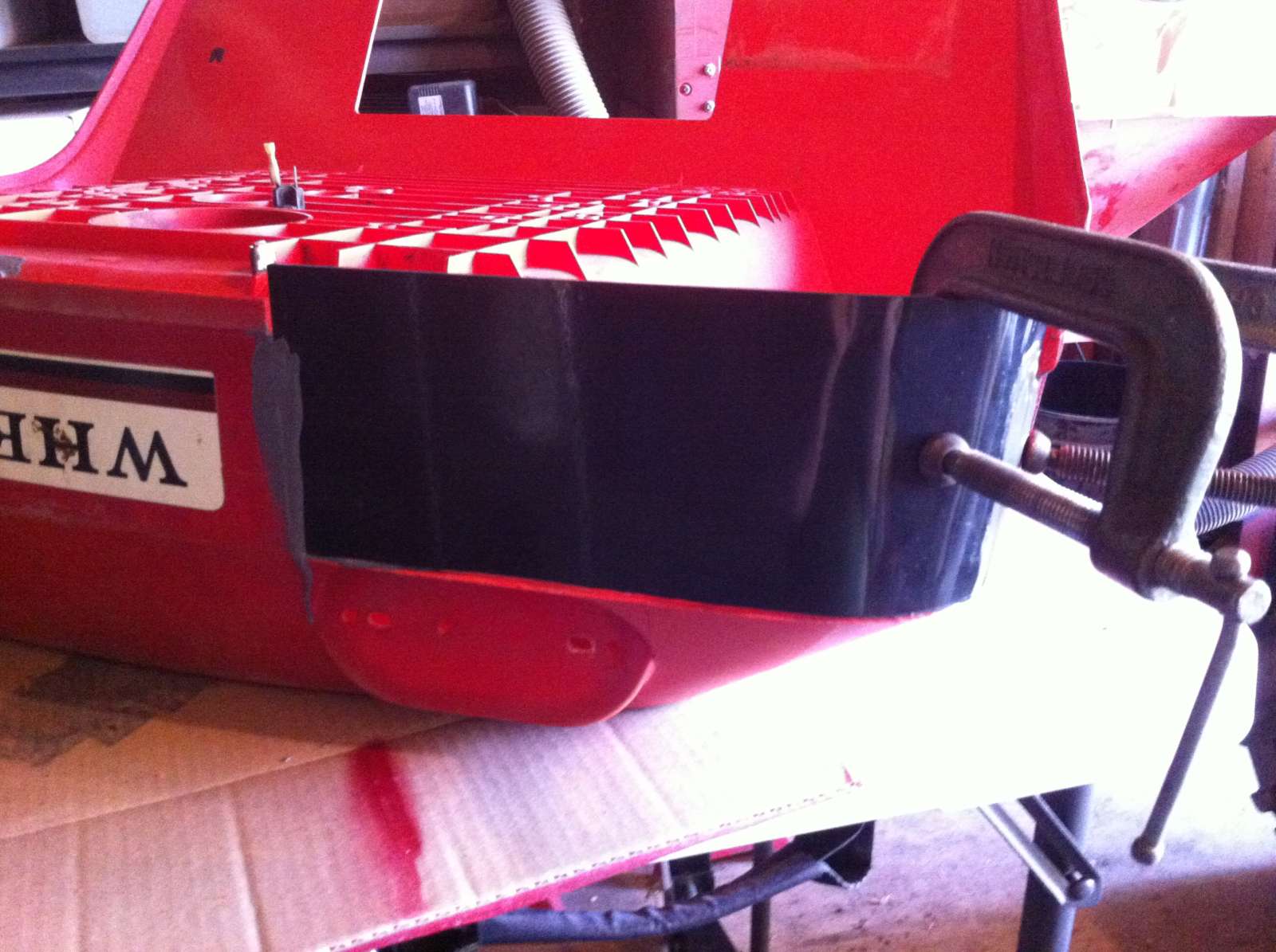

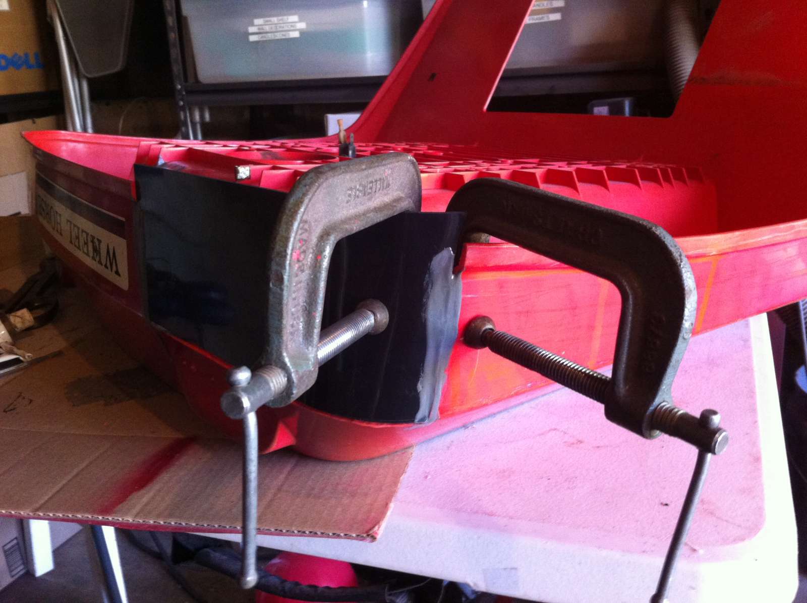

Here we go
Squared up the area, and cut and shaped 1/8" ABS. Used heat gun to get the curve.
Decided that strength was needed so I am using small squares of sheet metal.
Covered the entire piece of metal with JB and clamped.
Also repaired a large crack down the middle with same process.

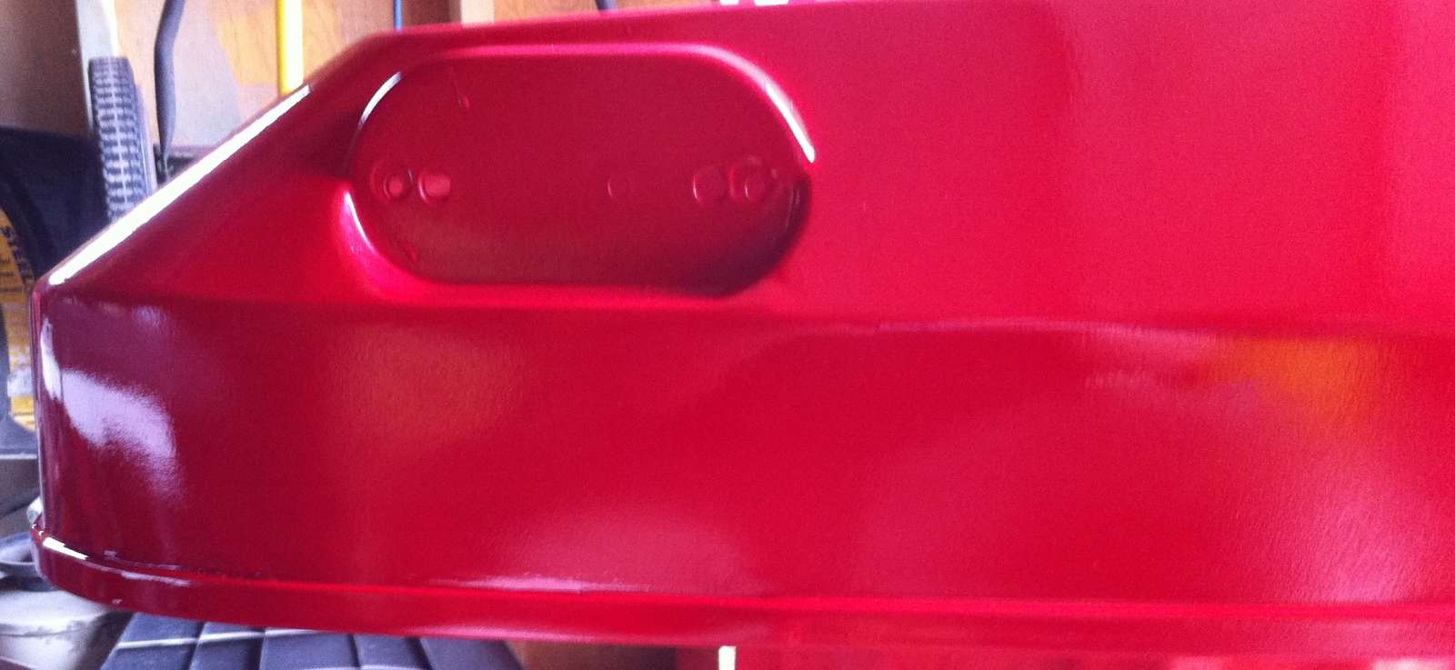

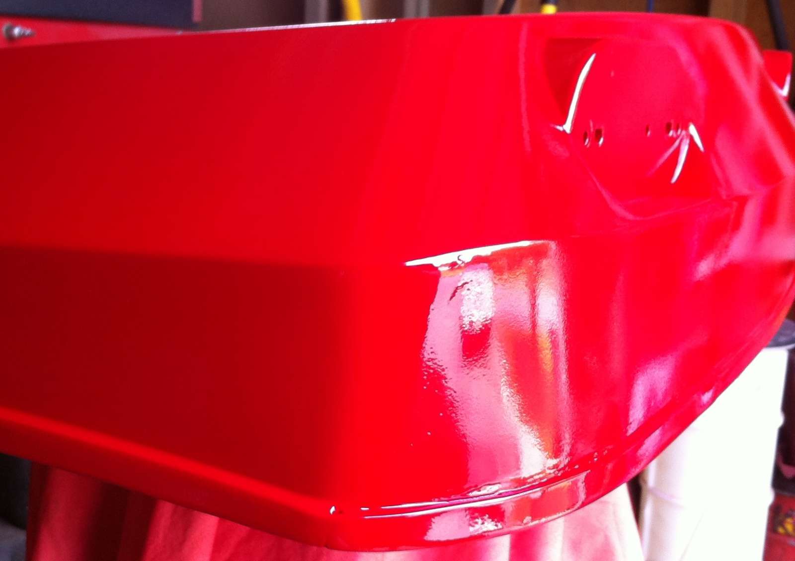

Finally the new fender has emerged!

14 May 2015 20:10 #4500
Replied by nappypappy on topic Plastic fender repair
:cool looking good.
