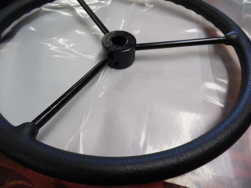

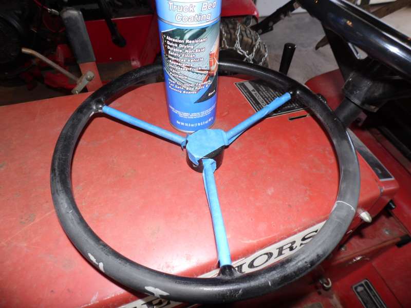

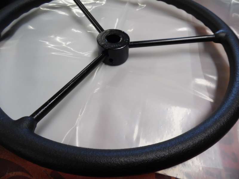

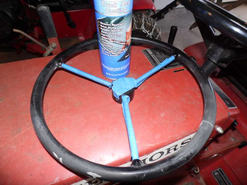

Some time ago my son asked what to use on the floorboards of his resto JD210 and after pondering the possibilities, skateboard tape etc., we decided on truck bed liner as an alternative. I don't have pics but it came out great, especially on the irregular surfaces. That got me to thinking about the resto on my '60 Suburban's steering wheel. Lots of cracks and missing chunks but mechanically sound. After filling the cracks and voids with 3M Plastic Metal I sprayed 3 coats of DupliColor Bed Liner on it followed by Valspar satin black for the hub and spokes. Here is the before and after.
A very nice pebbly, semi-soft texture and I couldn't be more pleased with it!

Replied by Geno on topic Bed Liner Uses
That is pretty wow Major. Bet the wheel has a good grip too. :goodpost
06 Apr 2015 19:12 #2738
Replied by M Bailey on topic Bed Liner Uses
Geno, I'm tickled to death with the outcome and yes, the grip feels perfect!
