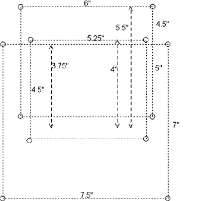

The seat only has one set of holes that fit....On the diagram I posted they are 4 1/2 back from the front and 11 1/2 back from the front....so look at the spring hole and measure 4 1/2 inches towards the steering wheel.....that will be the front of the seat. The seat you have may be the same. Just drill new holes in the spring......

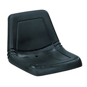

The last seat I bought was one of these for my 416-8 from ASC
LINK
With this bolt pattern
Just over $50 shipped. Read the reviews.
On edit, my son bought one of these for his (my old) JD210 and likes it as well.

to everyone once again. You guys are the best. MBailey...that's the exact seat I have been looking for. Ordering it now. Thanks!!

MBailey and GT14, the mid back seat arrived from Agricultural Supply and was installed yesterday. Shipping was nearly as much as the seat itself at $22, but for the money, this was a great buy. I thought I had a photo of it installed, but I must have taken the pan and hood off the tractor before snapping a photo. Thanks again for everyone's input on this subject...I searched high and low for a seat that would work, and this surely fits the bill!
