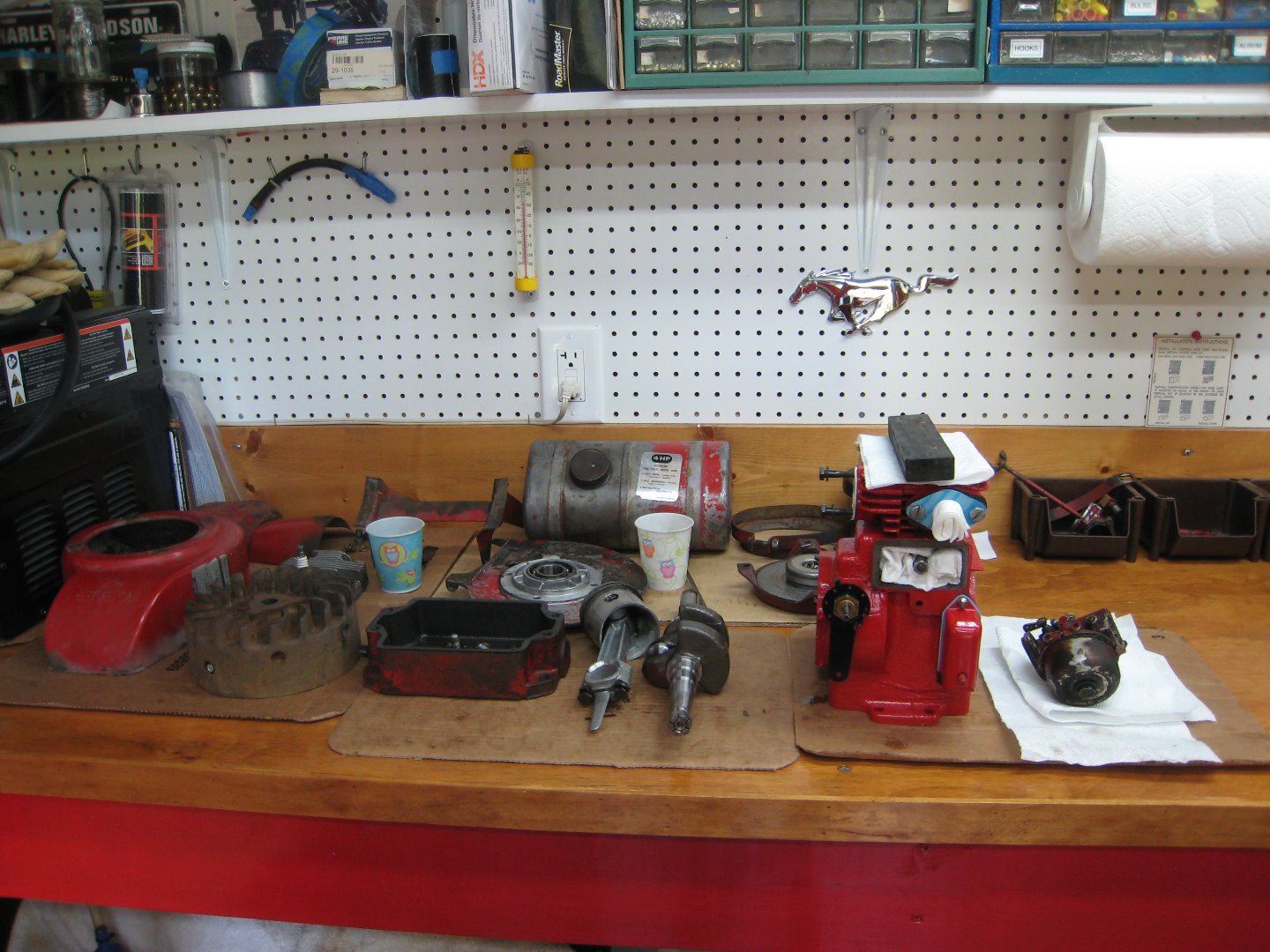

Started taking the Kohler K91T apart today and was pleasantly surprised. 75% of the parts on the motor are in good shape. The parts I needed most, rod, crank and flywheel were in great shape. The carb is original, going to keep it, there easy to rebuild. One other thing I like is all the fasteners/bolts are original, its hard to find that hardware any more.

wow a CLEAN bench........motor parts look good too..................

Top notch as always Motor, my first thought is always I wish you were closer.
19 May 2018 05:37 #14629
Cardboard bench savers with rounded corners, OCD to the max. :dance3 :dance2 :dance3
19 May 2018 08:49 #14633
My wife says the same thing about the cardboard :blissGT 14 wrote: Cardboard bench savers with rounded corners, OCD to the max. :dance3 :dance2 :dance3
