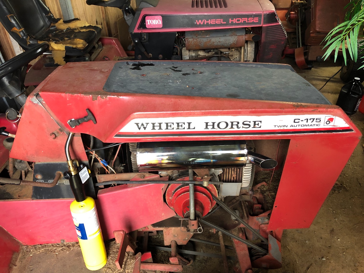

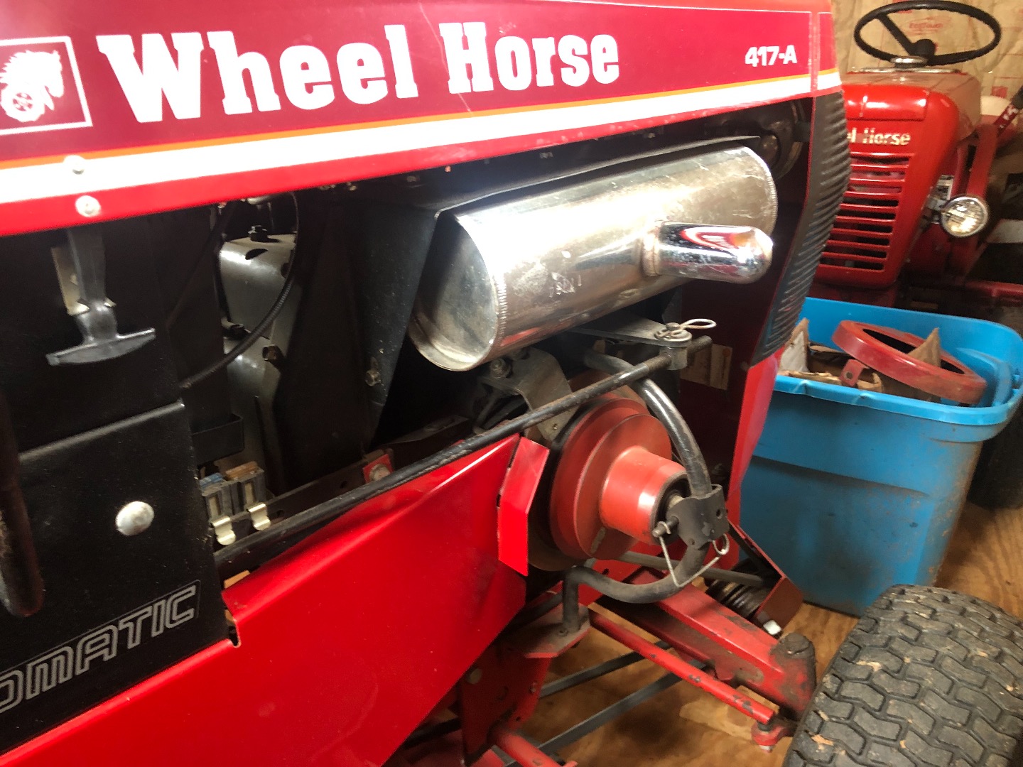

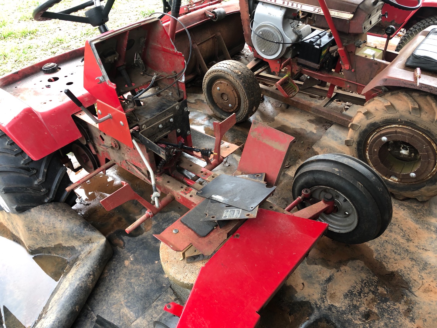

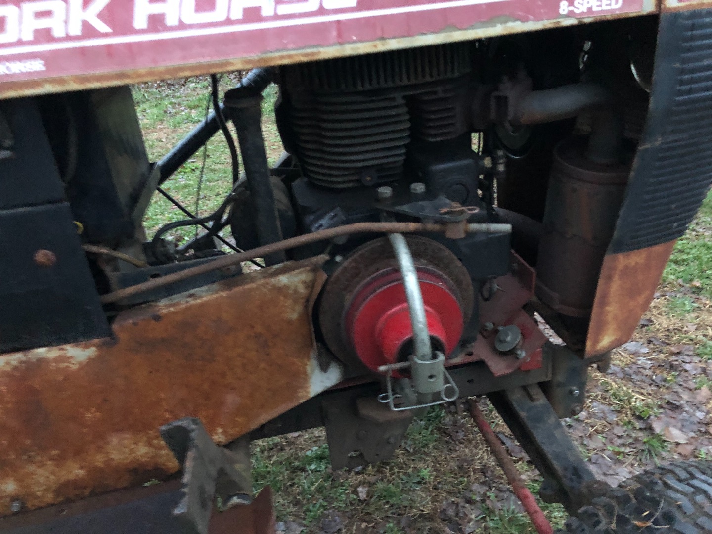

I took some pictures to help me explain what I’m up to, probably should have led with them :confused1
I’m somewhat downsizing and swapping engines and other parts to build and keep what I’d consider my ideal herd.
My grey work horse that my uncle bought new in 85 (it’s an 84 model) will be back on mowing duty. I robbed the engine off my 165 to bring it back to life.
The 175 is a pos mut but has a great series 2 wheel horse spec replacement engine. That’s going in the 165. I’ve got a 417 that’s original and in near perfect condition. I like that setup better than the shaker mount so wanna incorporat that style setup on a black hood

Can you use the shaker plate for the steel mount? If you cut off the upward swing for the rubber mounts is there enough room left to drill the holes to mount it directly to the frame? Unless you want it factory that is...
